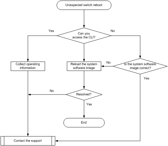

Unexpected switch reboot
Symptom
The switch reboots unexpectedly while it is operating.
Troubleshooting flowchart
Figure 1 Troubleshooting unexpected switch reboot
Solution
To resolve the issue:
1.        Check whether you can access the CLI after the switch reboots.
¡  If you can access the CLI, execute the display diagnostic-information command to collect operating information.
¡  If you cannot access the CLI, go to step 2.
2.        Verify that the system software image on the switch is correct:
Log in to the switch through the console port and restart the switch. If the system reports that a CRC error has occurred or that no system software image is available, use the BootWare menu to download the system software image and reboot the switch. The switch loads the system software image.
3.        If the issue persists, contact H3C Support.

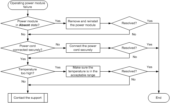

Operating power module failure
Symptom
An operating power module has failed.
Figure 2 Troubleshooting operating power module failure
Solution
1.        Identify the operating state of the power module.
<Sysname> display power
 Slot 2:
 PowerID State          Mode   Current(A)  Voltage(V)  Power(W)
 1       Normal         AC        --          --          --
 2       Absent         --        --          --          --
If the power module is in Absent state, go to step 2. If the power module is in Fault state, go to step 3.
2.        Remove and reinstall the power module to make sure the power module is installed securely. Then, execute the display power command to verify that the power module has changed to Normal state. If the power module remains in Absent state, replace the power module.
3.        When the power module is in Fault state, perform the following tasks:
a.    Verify that the power module is connected to the power source securely and is powered on. If it has been disconnected from the power source (The switch is being powered up with another power module.), connect the power source to it.
b.    Verify that the power module is in an acceptable temperature range. Dust buildup might cause high temperature. If dust is accumulated on the power module, remove the dust. Then remove and reinstall the power module. Execute the display power command to verify that the power module has changed to Normal state. If the power module remains in Fault state, go to step c.
c.    Install the power module into an empty power module slot. Then execute the display power command to verify that the power module has changed to Normal state in the new slot. If the power module remains in Fault state, replace the power module.
4.        If the issue persists, contact H3C Support.

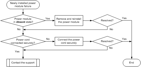

Newly installed power module failure
Symptom
A newly installed power module has failed.
Figure 3 Troubleshooting newly installed power module failure
Solution
 Slot 1:
2.        When the power module is in Absent state, perform the follow tasks:
a.    Remove and reinstall the power module to make sure the power module is installed securely. Then execute the display power command to verify that the power module has changed to Normal state. If the power module remains in Absent state, go to step b.
b.    Remove and install the power module into an empty power module slot. Then execute the display power command to verify that the power module has changed to Normal state in the new slot. If the power module remains in Absent state, go to step 4.
3.        Remove and install the power module into an idle power module slot. Then execute the display power command to verify that the power module has changed to Normal state in the new slot. If the power module remains in Fault state, go to step 4.

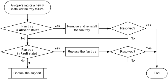

Fan tray failure
Symptom
An operating fan tray or a newly installed fan tray has failed.
Figure 4 Troubleshooting fan tray failure
Solution
1.        Display fan tray information.
<Sysname> display fan
 Slot 1:
 Fan 1:
 State    : Normal
 Airflow Direction: Port-to-power
 Prefer Airflow Direction: Port-to-power
 Fan 2:
 State    : Normal
¡  If the Airflow Direction value is different from the Prefer Airflow Direction value, replace the fan tray with one that has an airflow direction as required, or execute the fan prefer-direction command to configure the preferred airflow direction as required.
¡  If the fan tray is in Absent state, go to step 2.
¡  If the fan tray is in Fault state, go to step 3.
2.        Remove and reinstall the fan tray to make sure the fan tray is installed securely. Then execute the display fan command to verify that the fan tray has changed to Normal state. If the fan tray remains in Absent state, replace the fan tray.
3.        If the fan tray is in Fault state, perform the following tasks:
a.    Execute the display environment command to display temperature information. If the temperature continues to rise, put your hand at the air outlet vents to feel if air is being expelled out of the air outlet.
b.    If no air is being expelled out of the air outlet vents, remove and reinstall the fan tray. Then execute the display fan command to verify that the fan tray has changed to Normal state. If the fan tray remains in Fault state, replace the fan tray.
You must make sure the switch operating temperature is below 60°C (140°F) while you replace the fan tray. If a new fan tray is not readily available, power off the switch to avoid damage caused by high temperature.

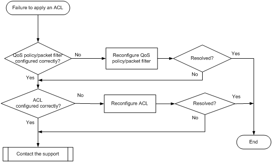

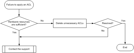

ACL application failure with an error message
Symptom
The system fails to apply a packet filter or an ACL-based QoS policy to the hardware. It also displays the "Reason: Not enough hardware resource" message.
Figure 5 Troubleshooting an ACL application failure
Solution
1.        Execute the display qos-acl resource command, and then check the Remaining field for ACL resources insufficiency.
If this field displays 0, the ACL hardware resources are exhausted.
2.        To free hardware resources, delete unnecessary ACLs.
ACL application failure without an error message
Symptom
The system applies a packet filter or an ACL-based QoS policy to the hardware. However, the ACL does not take effect.
Figure 6 Troubleshooting an ACL application failure
Solution
Choose a solution depending on the module that uses the ACL.
ACL used in a QoS policy
To resolve the issue when the ACL is used in a QoS policy:
1.        Verify that the QoS policy is configured correctly:
a.    Use one of the following commands to check the QoS policy for configuration errors, depending on the policy application destination:
Destination
Interface
display qos policy interface
VLAN
display qos vlan-policy
Global
display qos policy global
b.    If the QoS policy contains a class-behavior association, execute the display traffic classifier user-defined command and the display traffic behavior user-defined command to check for traffic class and behavior configuration errors, respectively.
-      If they are configured incorrectly, reconfigure them.
-      If they are configured correctly, go to step 2.
2.        Verify that the ACL is configured correctly.
Execute the display acl command to check whether the ACL is configured correctly.
¡  If the ACL is configured incorrectly, reconfigure it.
¡  If the ACL is configured correctly, go to step 3.
ACL used in a packet filter
To resolve the issue when the ACL is used in a packet filter:
1.        Verify that the packet filter is configured correctly.
Execute the display packet-filter command to check whether the packet filter is configured correctly.
¡  If there are any configuration errors, reconfigure the packet filter.
¡  If there is no configuration error, go to step 2.

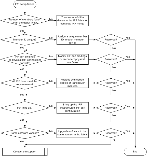

IRF fabric establishment failure
Symptom
An IRF fabric cannot be established.
Figure 9 Troubleshooting IRF fabric establishment failure
Solution
1.        Verify that the number of member devices does not exceed 9.
If you are adding a new member device to an existing IRF fabric or merging IRF fabrics, use the display irf command to identify the number of member devices in the IRF fabrics. If the total number of member devices exceeds the upper limit, the IRF setup will fail.
2.        Verify that the member ID of each member device is unique:
a.    Execute the display irf command to view the member ID of each member device.
b.    Assign a unique member ID to each member.
-      If you are adding a new member device to an existing IRF fabric, assign the member device a member ID that is not being used in the IRF fabric.
-      If you are merging IRF fabrics, make sure each member device in these IRF fabrics has a unique member ID.
3.        Verify that the IRF port bindings and physical IRF link connections are correct:
IMPORTANT
IMPORTANT:
When you connect two neighboring IRF members, you must connect the physical ports of IRF-port 1 on one member to the physical ports of IRF-port 2 on the other.
a.    Execute the display irf configuration command on each
b.     member device, and check the IRF-Port1 and IRF-Port2 fields for IRF port bindings.
c.    Verify that the physical IRF connections are consistent with the IRF port bindings.
d.    If there are binding errors or connection inconsistencies, reconfigure the IRF port bindings or reconnect the physical IRF ports.
4.        Verify that the IRF links meet the requirements.
For information about the interfaces that can be used as IRF physical interfaces, see the switch installation guide or the IRF configuration in the virtual technologies configuration guide for your switches. In addition, follow these restrictions and guidelines:
¡  Typically, a port must operate at its highest rate when it is used as an IRF physical interface. However, if you connect a 10G rate autosensing Ethernet port to a 5G rate autosensing Ethernet ports, the 10G rate autosensing Ethernet port will operate at 5 Gbps.
¡  The breakout interfaces of a QSFP+ or OSFP28 port cannot be used as IRF physical interfaces.
¡  Ports on the LSPM4G4T6P module cannot be used as IRF physical interfaces.
When you select transceiver modules or cables, follow these restrictions and guidelines:
¡  Ethernet ports that operate at different rates have different requirements for cables or transceiver modules. For more information, see the switch installation guide.
¡  The cable or transceiver module for an IRF physical interface must match the rate of the interface.

5.        Verify that all IRF links are up:
a.    Execute the display irf topology command, and then check the Link field.
-      If the Link field for each IRF port does not display DOWN, go to step 6.
-      If the Link field for an IRF port displays DOWN, go to step b.
b.    Execute the display irf link command, and then check the Status field of the physical ports bound to the IRF port.
-      If the field displays DOWN or ADM (administratively down) for all the physical ports, remove the link failures or use the undo shutdown command to bring up the administratively down ports.
-      If the field displays UP for at least one of the physical ports, go to step c.
c.    Save the configuration, and then execute the irf-port-configuration active command in system view to activate the IRF port configuration.
IMPORTANT
IMPORTANT:
Activating IRF port configuration requires a reboot. To prevent configuration loss, you must save the configuration before you execute the irf-port-configuration active command.
6.        Verify that all member devices use the same software version:
a.    Execute the display version command to identify the software version of each member device.
b.    Upgrade the software of all member devices to the same version.
Typically, the irf auto-update enable command can automatically synchronize a member device with the software version of the master device. However, the synchronization might fail when the gap between the software versions is too large. For more information, see the release notes.
7.        If the issue persists, contact H3C Support.

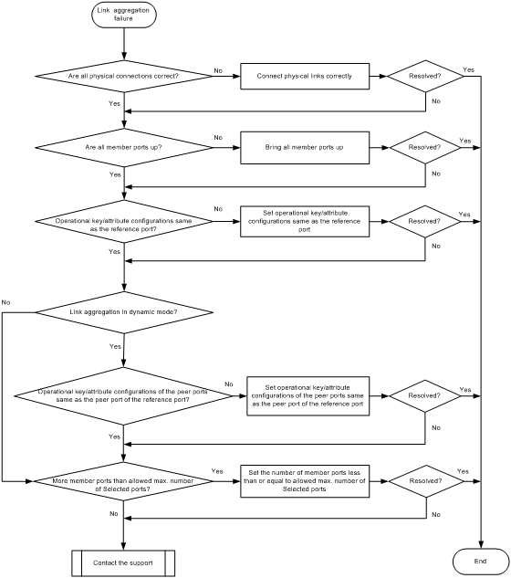

Link aggregation failure
Symptom
Some member ports fail to be placed in Selected state, and link aggregation does not operate correctly.
Figure 10 Troubleshooting link aggregation failure
Solution
1.        Verify that all physical connections are correct.
You can verify the physical connections against your network plan.
2.        Verify that all member ports are up:
a.    Execute the display interface command to display the status of the member ports.
b.    If the member ports are down, follow the solution in "Troubleshooting ports" to troubleshoot the issue.
3.        Verify that the member ports have the same operational key and attribute configurations as the reference port:
a.    Execute the display link-aggregation verbose command to display the Selected state of the member ports.
b.    Execute the display current-configuration interface command to display the configurations of the aggregate interface and the Unselected ports.
c.    Configure the Unselected ports to make sure they have the same operational key and attribute configurations as the reference port.
4.        Identify the aggregation mode of the aggregation group.
¡  If the aggregation mode is static, proceed to step 6.
¡  If the aggregation mode is dynamic, proceed to step 5.
5.        Verify that the peer member ports have the same operational key and attribute configurations as the peer port of the reference port:
a.    Execute the display current-configuration interface command on the peer device to display the configurations of the peer member ports.
b.    Configure the peer member ports to make sure the peer ports have the same operational key and attribute configurations as the peer port of the reference port.
6.        Verify that the number of member ports in the aggregation group does not exceed the configured maximum number of Selected ports.
a.    Execute the link-aggregation selected-port maximum command to set the maximum number of Selected ports allowed in the aggregation group. The value range is 1 to 16.
b.    Execute the display link-aggregation verbose command to verify that the number of member ports does not exceed the configured maximum number of Selected ports.
If the number of member ports exceeds the maximum number of Selected ports, the ports with higher port numbers are in Unselected state.
c.    Use the undo port link-aggregation group command to remove undesired member ports from the aggregation group.
This ensures that all member ports you assign to the aggregation group can become Selected ports.

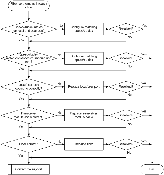

Fiber port remains in down state
Symptom
A fiber port remains in down state.
Figure 11 Troubleshooting fiber port's failure to come up
Solution
1.        Verify that the speed and duplex mode of the local port match the speed and duplex mode of the peer port:
a.    Execute the display interface brief command to examine whether the speed and duplex mode of the port match the speed and duplex mode of the peer port.
b.    If they do not match, use the speed command and the duplex command to set the rate and duplex mode for the port.
2.        Verify that the speed and duplex mode of the local port match the speed and duplex mode of the transceiver module:
a.    Execute the display interface brief command to examine whether the speed and duplex mode of the port match the speed and duplex mode of the transceiver module.
3.        Verify that the local port and its peer port are operating correctly:
a.    Use a cable (used for short-haul connection) supported by the local port to directly connect the local port to another fiber port on the local end.
b.    Identify whether the local port comes up:
-      If the port comes up, the peer port fails. Replace the peer port with a new port operating correctly.
-      If the port remains in down state, the local port fails. Replace the local port with a new port operating correctly.
4.        Verify that the transceiver module and cable are operating correctly:
a.    Use the display transceiver alarm interface command to display the alarms present on the transceiver module:
-      The device displays None if no error occurs.
-      The device displays alarms if the transceiver module fails or the type of the transceiver module does not match the port type.
b.    Use an optical power meter to verify that the Tx power and Rx power of the transceiver module are stable and are within the correct range.
c.    Execute the display transceiver interface command to verify that the wavelength and transmission distance of the local transceiver module are consistent with the wavelength and transmission distance of the peer transceiver module.
d.    If the transceiver module is not operating correctly, replace it with a H3C transceiver module that matches the fiber port.
For more information about transceiver modules and cables, see the installation guide.
When you use a QSFP+ to SFP+ cable to connect a 40-GE QSFP+ fiber port, you must use an optical attenuator because the Tx optical power of the QSFP+ transceiver module exceeds the upper Rx optical power limit of the SFP+ transceiver module.
5.        Verify that the fiber matches the transceiver module. If they do not match, replace the fiber with a new one that matches the transceiver module.
For more information about fibers, see the installation guide.
6.        If the issue persists, contact H3C Support, and provide the following information:
<Sysname> display diagnostic-information
Save or display diagnostic information (Y=save, N=display)? [Y/N]:Y

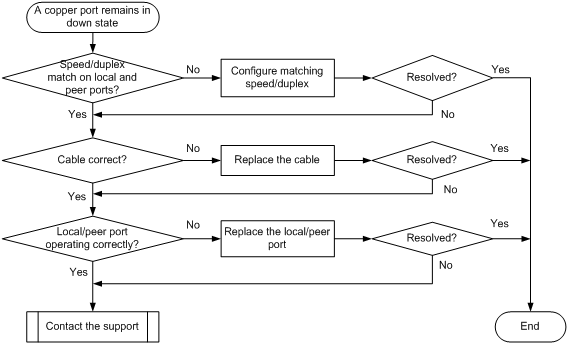

Copper port remains in down state
Symptom
A copper port remains in down state.
Figure 12 Troubleshooting copper port's failure to come up
Solution
2.        Verify that the cable is operating correctly:
a.    Use a cable that has been proved operating correctly to connect the port and its peer port.
b.    Identify whether the port comes up:
-      If the port comes up, the original cable fails. Replace the original cable.
-      If the port remains in down state, go to the next step.
a.    Use a cable supported by the local port to directly connect the local port to another copper port of the same rate on the local end.
4.        If the issue persists, contact H3C Support, and provide the following information:

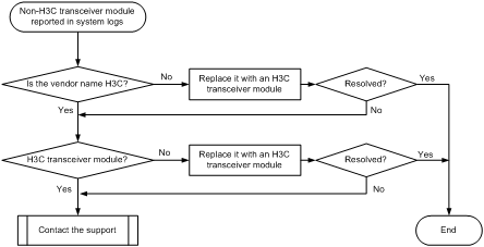

Non-H3C transceiver module
Symptom
The output from the display logbuffer command shows that the transceiver module is not an H3C transceiver module.
<Sysname> display logbuffer
   Ten-GigabitEthernet1/0/1: This transceiver is NOT sold by H3C. H3C therefore shall NOT guarantee the normal function of the device or assume the maintenance responsibility thereof!
Figure 13 Troubleshooting non-H3C transceiver module
Solution
1.        Execute the display transceiver interface command to view the vendor name of the transceiver module.
<Sysname> display transceiver interface ten-gigabitethernet 1/0/1
Ten-GigabitEthernet1/0/1 transceiver information:
  Transceiver Type              : 10G_BASE_SR4_SFP
  Connector Type                : MPO
  Wavelength(nm)                : 850
  Transfer Distance(m)          : 100(OM3),150(OM4)
  Digital Diagnostic Monitoring : YES
  Vendor Name                   : H3C
2.        Perform either of the following tasks:
¡  If the vendor name field does not display H3C, replace the transceiver module with an H3C transceiver module.
¡  If the vendor name field displays H3C, execute the display hardware internal transceiver register interface command in probe view. Provide the transceiver module information to H3C Support to verify that the transceiver module is an H3C transceiver module. If it is not an H3C transceiver module, replace it with an H3C transceiver module.
<Sysname> system-view
[Sysname] probe
[Sysname-probe] display hardware internal transceiver register interface Ten-GigabitEthernet1/0/1 device a0 address 0 le 128
Ten-GigabitEthernet1/0/1 transceiver device a0 register information:
  0000:    03    04    07    00    00    00    02    00
  0008:    00    00    00    03    0d    00    64    00
  0010:    00    00    00    00    48    69    73    65
  0018:    6e    73    65    20    20    20    20    20
  0020:    20    20    20    20    00    00    00    00
  0028:    4c    54    44    31    35    33    31    2d
  0030:    42    43    2b    2d    48    33    43    20
  0038:    57    20    20    20    06    0e    00    d4
  0040:    00    1a    14    14    5a    57    35    30
  0048:    39    43    30    30    30    30    38    20
  0050:    20    20    20    20    30    39    31    32
  0058:    30    31    20    20    68    b0    01    f2
  0060:    48    33    43    00    00    00    00    00
  0068:    00    00    00    00    00    00    00    00
  0070:    00    00    00    00    00    06    0e    05
  0078:    00    00    00    9e    00    89    00    fe

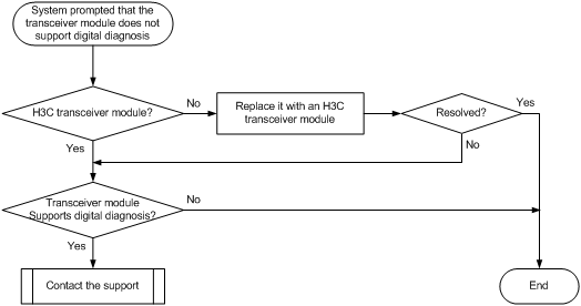

Transceiver module does not support digital diagnosis
Symptom
The output from the display transceiver diagnosis interface command shows that the transceiver module does not support the digital diagnosis function.
<Sysname> display transceiver diagnosis interface ten-gigabitethernet 1/0/1
The transceiver does not support this function.
Figure 14 Troubleshooting digital diagnosis failure on a transceiver module
Solution
1.        Verify that the transceiver module is an H3C transceiver module:
¡  If the vendor name field displays H3C, execute the display hardware internal transceiver register interface command in probe view. Provide the transceiver module information to H3C Support to verify that the transceiver module is an H3C transceiver module. If it is not, replace it with an H3C transceiver module.
2.        Execute the display transceiver interface command to save the transceiver module information, and contact H3C Support to verify that the transceiver module supports the digital diagnosis function.
  Vendor Name                   : H3C
3.        If the issue persists, execute the display diagnostic-information command to save the diagnostic information, and contact H3C Support.

b.    If the optical power of the transceiver module is not within the correct range, replace the transceiver module with a transceiver module of the same model that is operating correctly.
3.        Verify that the port configurations are correct:
a.    Execute the display interface brief command.
b.    Determine whether the speed and duplex mode of the port match the speed and duplex mode of the peer port.
c.    If they do not match, use the speed command and the duplex command to set the speed and duplex mode for the port.
4.        Verify that the port and the link medium are operating correctly:
a.    Plug the link medium into another port that is operating correctly, and determine whether the same issue occurs.
b.    If the issue still occurs, verify that the following items are operating correctly:
-      Intermediate links and devices, including optical-to-electrical converters, cable terminal racks, and transmission devices.
-      Transmission medium, including network cables, optical fibers, and transceiver modules.
c.    Examine the port:
-      If the port is a copper port, directly connect the port to a PC.
-      If the port is a fiber port, replace the transceiver module plugged into the port.
5.        Determine whether the port has received a large amount of flow control frames:
a.    Use the display interface command to view the number of pause frames.
If the number of pause frames is accumulating, you can determine that the port has sent or received a large amount of flow control frames.
b.    Verify that the incoming traffic and outgoing traffic have not exceeded the maximum traffic processing capability of the local device and the peer device.
6.        If you determine that the configurations, the peer port, and the link are correct but the issue persists, perform the following tasks:
a.    Use the display diagnostic-information command to collect the diagnostic information.
b.    Contact H3C Support.

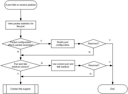

Failure to receive packets
Symptom
A port is up, but it cannot receive packets.
Figure 16 Troubleshooting the failure to receive packets
Solution
1.        Examine the packet statistics of the port:
a.    (Optional.) Use the reset counter interface command to clear the packet statistics of the port.
This command resets the values of each statistical field to 0, so that you can view the statistics changes more clearly.
b.    Determine whether the ports at both ends are always up, and use the display interface command to determine whether the number of incoming packets is accumulating. At the same time, examine the outgoing packet statistics of the peer port.
c.    View the values of the error packet fields and determine whether the number of error packets is accumulating.
2.        Verify that the port configurations do not affect packet receiving:
a.    Use the display interface brief command to verify that the port configurations are correct.
The port configurations include the duplex mode, speed, port type, and VLAN configurations of the ports at both ends of the link.
b.    If configuration errors exist, modify the port configurations. If the number of incoming packets in the output from the display interface command is accumulating, you can determine that the port can receive packets.
c.    If the port fails to receive packets, use the shutdown command and then the undo shutdown command to re-enable the port. If the number of incoming packets in the output from the display interface command is accumulating, you can determine that the port can receive packets.
d.    If the port is configured with STP, use the display stp brief command to verify that the port is not in the discarding state.
e.    If a port is set to the discarding state by STP, examine and modify the STP-related configurations to resolve the issue.
As a best practice, configure the port as an edge port or disable STP on the port if it is directly connected to a terminal.
f.     If the port is assigned to an aggregation group, use the display link-aggregation summary command to verify that the status of the port is Selected.
g.    If the status of the port is Unselected, the port cannot send or receive data packets.
h.    Determine the reasons why the port becomes Unselected, for example, the attribute configurations of the port are different from the reference port. Modify the attribute configurations of the port to make the port become Selected.
3.        Verify that the port and the link medium are operating correctly:
c.    Examine the port.
4.        If you determine that the configurations, the peer port, and the link are correct but the issue persists, perform the following tasks:

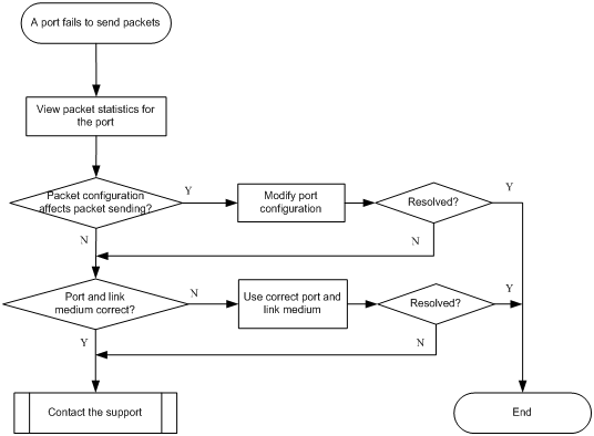

Failure to send packets
Symptom
A port is up, but it cannot send packets.
Figure 17 Troubleshooting the failure to send packets
Solution
b.    Determine whether the ports at both ends are always up, and use the display interface command to determine whether the number of outgoing packets is accumulating.
c.    Determine whether the number of error packets is accumulating.
2.        Verify that the port configurations do not affect packet sending:
b.    If configuration errors exist, modify the port configurations. If the number of outgoing packets in the output from the display interface command is accumulating, you can determine that the port can send packets.
c.    If the port fails to send packets, use the shutdown command and then the undo shutdown command to re-enable the port. If the number of outgoing packets in the output from the display interface command is accumulating, you can determine that the port can send packets.
3.        Verify that the port and the link medium are correct:

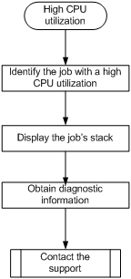

High CPU utilization
Symptom
The display cpu-usage command shows that the CPU utilization of the device is continuously higher than 80%.
Figure 18 Troubleshooting high CPU utilization
Solution
1.        Execute the display cpu-usage command multiple times to display CPU usage information. (Details not shown.)
2.        Identify the job with a high CPU utilization.
<Sysname> display process cpu
CPU utilization in 5 secs: 1.3%; 1 min: 1.5%; 5 mins: 1.5%
       JID      5Sec      1Min      5Min    Name
         1      0.0%      0.0%      0.0%    scmd
         2      0.0%      0.0%      0.0%    [kthreadd]
         3      0.0%      0.0%      0.0%    [migration/0]
         4      0.0%      0.0%      0.0%    [ksoftirqd/0]
         5      0.0%      0.0%      0.0%    [watchdog/0]
         6      0.0%      0.0%      0.0%    [migration/1]
         7      0.0%      0.0%      0.0%    [ksoftirqd/1]
         8      0.0%      0.0%      0.0%    [watchdog/1]
         9      0.0%      0.0%      0.0%    [events/0]
        10      0.0%      0.0%      0.0%    [events/1]
        11      0.0%      0.0%      0.0%    [khelper]
        12      0.0%      0.0%      0.0%    [kblockd/0]
        13      0.0%      0.0%      0.0%    [kblockd/1]
        14      0.0%      0.0%      0.0%    [ata/0]
        15      0.0%      0.0%      0.0%    [ata/1]
        16      0.0%      0.0%      0.0%    [ata_aux]
        17      0.0%      0.0%      0.0%    [khubd]
        18      0.0%      0.0%      0.0%    [kseriod]
        19      0.0%      0.0%      0.0%    [vzmond]
        20      0.0%      0.0%      0.0%    [pdflush]
        21      0.0%      0.0%      0.0%    [pdflush]
The output shows the average CPU usage values of jobs during the last 5-second, 1-minute, and 5-minute intervals. Typically, the average CPU usage of a job is approximately 5%.
3.        Display the job's stack.
The following example was created for job 17 in probe view.
[Sysname] probe
[Sysname-probe] follow job 17
Attaching to process 17 ([khubd])
Iteration 1 of 5
Kernel stack:
[<c01d54a8>] hub_thread+0x88c/0xa64
[<c006ce28>] kthread+0xfc/0x12c
[<c00588d0>] do_exit+0x0/0x818
[<ffffffff>] 0xffffffff
Iteration 2 of 5
Kernel stack:
Iteration 3 of 5
Kernel stack:
Iteration 4 of 5
Kernel stack:
Iteration 5 of 5
Kernel stack:
[Sysname-probe]
4.        Use the display diagnostic-information command to collect diagnostic information.
5.        Save the information displayed in the previous steps.
6.        Contact H3C Support.

Each value line shows the memory information for a memory portion. The product of the Number and Size fields shows the capacity of the memory portion. If the capacity of a memory portion continually increases, the memory portion is being continually used. To determine whether there is an issue with the memory portion, you must observe the capacity change and change speed of a memory portion for a period of time. The memory leak process might be slow and you might need to spend a long time (even weeks) observing the leak symptom.
2.        Save the information displayed in the previous step and contact H3C Support.
IMPORTANT
IMPORTANT:
For quick troubleshooting, do not reboot the device before you contact H3C Support. The previous step only identifies the memory portions that have issues. Further information is required to locate the code section that has issues.
Related commands
This section lists the commands that you might use for troubleshooting system management.
Description
display cpu-usage
Displays the current CPU usage statistics.
display memory
Displays memory usage statistics.
display process cpu
Displays the CPU usage statistics for jobs.
display system internal kernel memory pool
Displays memory block usage statistics.
follow job job-id
Displays the stack of a job.

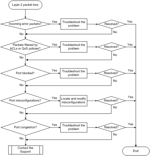

Layer 2 forwarding failure
Symptom
Layer 2 packet loss occurs when the switch forwards packets to a peer on the same network segment and in the same VLAN.
Figure 20 Troubleshooting Layer 2 packet loss failure
Solution
1.        Verify that no error packets have been received on the local port:
Execute the display interface command and check for error packets.
<Sysname> display interface ten-gigabitethernet 1/0/1
Current state: DOWN
Line protocol state: DOWN
IP packet frame type: Ethernet II, hardware address: 38ad-be30-b9bb
Description: Ten-GigabitEthernet1/0/1 Interface
Bandwidth: 10000000 kbps
Loopback is not set
Media type is not sure, Port hardware type is no connector
Unknown-speed mode, unknown-duplex mode
Link speed type is autonegotiation, link duplex type is autonegotiation
Flow-control is not enabled
Maximum frame length: 10000
Allow jumbo frames to pass
Broadcast max-ratio: 100%
Multicast max-ratio: 100%
Unicast max-ratio: 100%
PVID: 1
MDI type: Automdix
Port link-type: Access
 Tagged VLANs:   None
 Untagged VLANs: 1
Port priority: 0
Last link flapping: Never
Last clearing of counters: Never
 Peak value of input: 3 bytes/sec, at 2013-01-01 01:59:12
 Peak value of output: 0 bytes/sec, at 2013-01-01 00:01:24
 Last 300 seconds input:  0 packets/sec 3 bytes/sec 0%
 Last 300 seconds output:  0 packets/sec 0 bytes/sec 0%
 Input (total):  17 packets, 2344 bytes
          0 unicasts, 4 broadcasts, 13 multicasts, 0 pauses
 Input (normal):  17 packets, - bytes
 Input:  0 input errors, 0 runts, 0 giants, 0 throttles
          0 CRC, 0 frame, - overruns, 0 aborts
          - ignored, - parity errors
 Output (total): 0 packets, 0 bytes
          0 unicasts, 0 broadcasts, 0 multicasts, 0 pauses
 Output (normal): 0 packets, - bytes
 Output: 0 output errors, - underruns, - buffer failures
          0 aborts, 0 deferred, 0 collisions, 0 late collisions
          0 lost carrier, - no carrier
a.    If the statistics are not zero, the following issues might have occurred:
-      Inconsistent configuration—Verify that the local and peer ports have the same configuration (including speed and duplex mode). If they are not the same, modify the configuration of the local port.
-      Interface hardware failure—To test such a failure, connect the cable that is connected to the local port to a correctly operating port (for example, Port A) with the same configurations as the local port. If Port A forwards traffic correctly, you can determine that the hardware of the local port fails. In this event, you must replace the local port with a correctly operating port.
-      Transceiver module, fiber, or twisted pair failure—To test and resolve such a failure, replace the transceiver module, fiber, or twisted pair with a good one.
b.    If the issue persists, contact H3C Support.
When you contact H3C Support, provide the following diagnostic information if packet loss occurs on the chip port with which the interface is associated:
2.        Verify that packets are not mistakenly filtered out by ACLs:
a.    Examine the ACL and QoS policy configurations for packet filtering on the port, on the VLAN of the port, or globally. If packets are mistakenly filtered out, modify the ACL or QoS policy configuration.
-      To display the ACL configuration on the port for packet filtering, execute the display packet-filter command.
-      To display the QoS policy configuration on the port, execute the display qos policy command.
-      To display the QoS policy configuration on the VLAN of the port, execute the display qos vlan-policy command.
-      To display the global QoS policy configuration, execute the display qos policy global command.
b.    Verify that packets are not filtered out by ACLs automatically created by some features.
-      Execute the display this command in Ethernet interface view to verify that the ip source binding or ip verify source command is configured on the port. To display source guard binding entries, execute the display ip source binding or display ipv6 source binding command. If IP source guard is configured but the packets match no entry, further troubleshoot the issue based on the way the binding entries are created.
-      Determine whether the port is configured with the portal authentication. If portal authentication is configured, packets of users that fail to pass the portal authentication will be dropped by the port. Use the display portal interface command to display the portal configuration information of the specified VLAN interface. Determine whether the portal authentication can be disabled based on the network conditions. To disable the portal authentication, use the undo portal server server-name command in VLAN interface view of the VLAN to which the port belongs.
-      Use the display dot1x command to check whether 802.1X EAD assistant is enabled on the interface.
If 802.1X EAD assistant is enabled on the interface, packets will be discarded for unauthenticated users who access the network segments other than the Free IP.
-      Determine whether MFF is configured on the VLAN to which the port belongs. Use the display mac-forced-forwarding vlan command to display the MFF information of the specified VLAN. If no gateway information is displayed in the output, verify that ARP snooping is correctly configured based on the MFF operation mode.
3.        Verify that the port is not blocked:
¡  Execute the display stp brief command to verify that STP does not set the state of the port to discarding. When the port is in discarding state, it cannot forward traffic. As a best practice, disable STP on the port, or configure the port as an edge port if the port is connected to a terminal device.
¡  If the port belongs to an aggregation group, execute the display link-aggregation verbose command to identify the port status. When the port is an Unselected port, it cannot forward traffic. Locate the reasons why the port is in Unselected state. For example, the attribute configurations of the port are different from the configurations of the reference port.
¡  Identify whether the port is blocked by smart link. Use the display smart-link group command to view the port status. If the state of the port is STANDBY or DOWN, the port cannot forward traffic.
-      If the state of the port is DOWN, locate the reason for the port to be down. The possible reasons include: its uplink device is configured with monitor link, the link of the port fails, or the port is shut down. Further troubleshoot the issue based on the reason for the port to be down.
-      If the state of the port is STANDBY, perform an active/standby switchover in the smart link group.
4.        Examine the following configurations that might cause packet loss:
¡  VLAN configuration—Execute the display this command in Ethernet interface view to verify that the port is in the VLAN of the packets. If it is not, add the port to the VLAN.
¡  Blackhole MAC address entriesExecute the display mac-address blackhole command to display blackhole MAC address entries. If the packets are discarded because they match a blackhole MAC address entry, delete the entry. To delete the blackhole MAC address entry, execute the undo mac-address blackhole mac-address vlan vlan-id command.
¡  Rate limitExecute the display qos lr interface command to display the rate limit configuration on the port. If rate limit is configured on the port, make sure the committed information rate (CIR) and the committed burst size (CBS) are appropriate. To adjust the CIR and CBS values, execute the qos lr { inbound | outbound } cir committed-information-rate [ cbs committed-burst-size ] command.
¡  Storm suppressionExecute the display this command in Ethernet interface view to display the configuration of storm suppression. Storm suppression includes broadcast suppression, multicast suppression, and unknown unicast suppression. To adjust the suppression thresholds, execute the broadcast-suppression, multicast-suppression, and unicast-suppression commands, respectively.
5.        Verify that no congestion occurs by using the display qos queue-statistics interface command.
If congestion occurs, locate and resolve the issue by referencing related congestion management documents.
6.        If the issue persists, contact H3C Support.

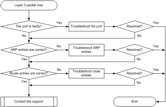

Layer 3 forwarding failure
Symptom
Packet loss occurs when the switch forwards packets to a different network.
Figure 21 Troubleshooting Layer 3 forwarding failure
Solution
1.        Verify that the port is not faulty (due to hardware or configuration issues).
If the port is faulty, follow the solution in "Layer 2 forwarding failure" to troubleshoot the issue.
2.        Verify that the ARP entry for the gateway is correct:
a.    Execute the display arp command to verify that the ARP entry for the gateway is correct.
If the switch has not learned the APR entry, execute the arp static command to configure a static ARP entry. If an incorrect ARP entry exists, execute the debugging arp packet command to locate the issue.
b.    Execute the display mac-address command to verify that the output interfaces in the MAC address entries and ARP entry are the same.
If the output interfaces are not the same, execute the reset arp command to clear the ARP entries. Then the switch can learn ARP entries again.
3.        Verify that route entries are correct:
a.    Execute the display ip routing-table command to verify that route entries are correct.
If incorrect route entries exist, troubleshoot the protocol that learns the route entries.
b.    Execute the display fib command to verify that the output interfaces in the FIB entries and route entries are the same.
If the output interfaces are not the same, execute the reset command to clear the route entries. Then the switch can learn route entries again.

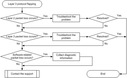

Protocol flapping
Symptom
The switch cannot send or receive protocol packets.
Figure 22 Troubleshooting protocol flapping
Solution
1.        Verify that Layer 2 is operating correctly, as described in "Layer 2 forwarding failure."
2.        Verify that Layer 3 is operating correctly, as described in "Layer 3 forwarding failure."
Execute the debug rxtx softcar show 1 command in en_diag view to check for software-related packet loss.
[Sysname] probe
[Sysname-probe] debug rxtx softcar show slot 1
ID  Type                RcvPps Rcv_All    DisPkt_All Pps  Dyn Swi Hash Am APps
0   ROOT                0      0          0          200  S   On  SMAC 0  0
1   ISIS                0      0          0          200  D   On  SMAC 8  512
2   ESIS                0      0          0          100  S   On  SMAC 8  512
3   CLNP                0      0          0          100  S   On  SMAC 8  512
4   VRRP                0      0          0          1024 S   On  SMAC 8  768
5   UNKNOWN_IPV4MC      0      0          0          100  S   On  SMAC 8  1024
6   UNKNOWN_IPV6MC      0      0          0          100  S   On  SMAC 8  1024
7   IPV4_MC_RIP         0      0          0          150  D   On  SMAC 8  512
8   IPV4_BC_RIP         0      0          0          150  D   On  SMAC 8  512
9   MCAST_NTP           0      0          0          100  S   On  SMAC 8  512
10  BCAST_NTP           0      0          0          100  S   On  SMAC 8  512
11  IPV4_MC_OSPF_5      0      0          0          100  S   On  SMAC 8  512
12  IPV4_MC_OSPF_6      0      0          0          100  S   On  SMAC 8  512
13  IPV4_UC_OSPF        0      0          0          200  S   On  SMAC 8  512
14  IPV4_MC_PIM         0      0          0          100  S   On  SMAC 8  512
15  IPV4_UC_PIM         0      0          0          100  S   On  SMAC 8  512
16  IPV4_IGMP           0      0          0          100  S   On  SMAC 8  512
17  LDP                 0      0          0          100  S   On  SMAC 8  512
18  IPV6_MC_PIM         0      0          0          100  S   On  SMAC 8  512
19  IPV6_UC_PIM         0      0          0          100  S   On  SMAC 8  512
20  IPV6_MLD            0      0          0          100  S   On  SMAC 8  512
21  IPV6_RIPNG          0      0          0          100  D   On  SMAC 8  512
When you contact H3C Support, provide diagnostic information if software-related packet loss occurred.

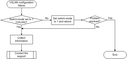

VXLAN configuration failure
Symptom
On a switch that acts as a leaf node, the system displays "The operation is not supported." message when one of the following operations is performed:
·          Configure the L3 VXLAN ID in VSI interface view.
·          Execute the vxlan command in VSI view.
Figure 23 VXLAN configuration failure
Solution
1.        Verify that the operating mode of the switch (configured by using switch-mode) is VXLAN.
a.    Display operating mode information.
<Sysname> display switch-mode status
     Switch-mode in use: NORMAL MODE(default).
     Switch-mode for next reboot: NORMAL MODE(default)
b.    If the switch-mode is not VXLAN, set it to 1, save the configuration, and reboot the switch.
[Sysname] switch-mode ?
  0  NORMAL MODE(default)
  1  VXLAN MODE
  2  802.1BR MODE
[Sysname] switch-mode 1
Reboot device to make the configuration take effect.
[Sysname] quit
<Sysname> reboot
Start to check configuration with next startup configuration file, please wait..
.......DONE!
Current configuration may be lost after the reboot, save current configuration?
[Y/N]:y
This command will reboot the device. Continue? [Y/N]:y
c.    Verify the switch-mode configuration after the switch finishes startup.
     Switch-mode in use: VXLAN MODE.
     Switch-mode for next reboot: VXLAN MODE.
2.        If the issue persists, contact H3C Support.
